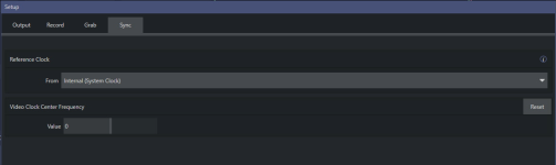

Something else that might be worth checking is the Sync mode. The Mini 4K defaults to GPU, but I've found that using the Internal clock sometimes works better (depend on the monitors you have connected to the system). Go to SETUP, then Sync and change the Reference Clock to Internal (System Clock) and see if that makes any difference.

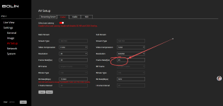

I think my issue is now resolved. After testing over the past two days, I discovered the problem was caused by the frame rate of the proxy streams output by the PTZ cameras.
During this process, I tried various solutions: replacing the switch, using 2.5G Ethernet ports with higher transmission speeds, powering each camera independently, updating and rolling back the TriCaster software version, lowering the output resolution, updating the graphics card driver, and updating the Windows operating system. However, none of these fixed the signal delay issue.
Finally, when I changed the PTZ cameras’ output resolution to 4K 30P, I noticed their proxy streams switched from 25fps to 30fps. I then tested with a 4K 29.97 session, and the delay between the cameras and the session disappeared completely.
After that, while keeping the proxy stream frame rate at 30fps, I tested the cameras with outputs set to 4K 50P and 4K 30P, paired with TriCaster sessions in 4K 50P, 4K 25P, and 4K 29.97. In all cross-tests, no delay occurred.
But when I changed the sub-stream (proxy stream) frame rate back to 25fps, the delay gradually became more noticeable over time.
Anyway, my problem is now solved, and I can finally get a good night’s sleep! Thank you both again for your help—especially Frank, who reminded me that TriCaster uses proxy streams for local previews. That gave me the key insight for my troubleshooting!

Just to add a supplement: For this model of PTZ camera, the maximum configurable frame rate of its proxy stream is 30fps, with an adjustable range of 1–30fps. I only tested 25fps and 30fps and haven’t tried other frame rates in between.
