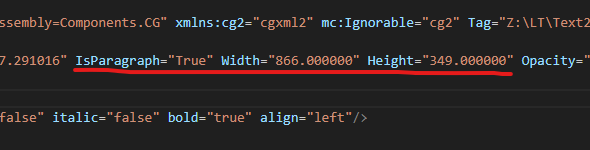

I figured out how to get paragraph text by manually editing the cgxml file.
First, import the PSD image into TriCaster. Then use the Export button (bottom left corner of title editor) and save out a cgxml file.
Now open the cgxml file in a text editor.
The data is XML formatted, and you will find lines that start with <ccg:CGText followed by a bunch of parameters. You will also see the text in the title on the line in question, so you know where to edit.
Scroll to the right on that line until find the parameter named IsParagraph="False" and change this to "True". You will also need to add a set of Width and Height parameters to define the size of the text box (I'm thinking these values are in pixels, but not 100% sure). Save the cgxml file.
Load the edit cgxml back into TriCaster and it will have text box that word wraps what is entered inside of it.
Here is an example of how my cgxml file looked after making these adjustments.

Playing with this a bit more, here is the easiest to get multi-line, word wrap, linebreak titles working.
  1. Create title in Photoshop, drag out a box of text to create a paragraph of text.
  2. Import PSD into TriCaster (you will see that there is a text box, but the word wrapping doesn't work once you edit).
  3. Export the title from the TriCaster (button at lower left corner of title editing panel)
  4. Open CGXML file into a text editor (VS Code or Notepad)
  5. Find the line of text in question (should be near the top of the file) and change the IsParagraph option from False to True.
  6. Save CGXML file
  7. Import the updated CGXML into TriCaster and word wrap is now working.
