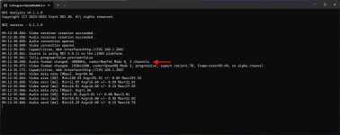

To start, try using NDI Analysis to see if there is audio contained in the NDI stream. An audio entry only appears if audio has been encoded into the signal. Here is the entry you would be looking for in the Analysis header data. Beyond this entry, if there is audio, you will see Audio size, Audio recv and Audio send data.
Does audio work if you use a tool like NDI Test Patterns as the source?

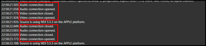

22:58:20.856: Video receiver creation succeeded.
22:58:20.859: Video connection opened.
22:58:20.859: Audio receiver creation succeeded.
22:58:20.862: Audio connection opened.
22:58:20.874: Source is using NDI 5.5.3 on the APPLE platform.
22:58:20.892: Audio format changed. 44100Hz, codec=NewTek Mode 0, 2 channels.
22:58:20.892: Video format changed. 1920x1080, codec=SpeedHQ Mode 2, progressive, aspect ratio=1.78, frame-rate=30.00, no alpha channel.
22:58:21.505: Audio connection closed.
22:58:21.658: Audio connection opened.
22:58:21.775: Video connection closed.
22:58:21.928: Video connection opened.
22:58:21.935: Source is using NDI 5.5.3 on the APPLE platform.
22:58:22.849: Audio connection closed.
22:58:23.003: Audio connection opened.
22:58:23.020: Video connection closed.
22:58:23.173: Video connection opened.
22:58:23.188: Source is using NDI 5.5.3 on the APPLE platform.

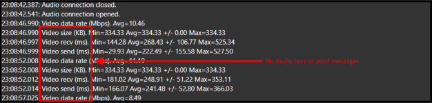

C:\Program Files\NDI\NDI 6 Analysis\x64>NDIAnalysis.exe /source:"BB-NDI (vMix - Output 1)"
NDI Analysis v6.1.1.0
Copyright (C) 2023-2024 Vizrt NDI AB. All rights reserved.
NDI version : 6.1.1.0
23:08:41.979: Video receiver creation succeeded.
23:08:41.982: Video connection opened.
23:08:41.983: Audio receiver creation succeeded.
23:08:41.987: Audio connection opened.
23:08:41.993: Source is using NDI 6.1.1.0 on the WIN64 platform.
23:08:41.995: Product, Long name=vMix 4K - 28.0.0.42 x64
23:08:41.996: Product, Short name=vMix
23:08:41.997: Product, Model=4K
23:08:41.999: Product, Manufacturer=vMix
23:08:42.000: Product, Version=28.0.0.42
23:08:42.015: Audio format changed. 44100Hz, codec=NewTek Mode 0, 2 channels.
23:08:42.017: Video format changed. 1920x1080, codec=SpeedHQ Mode 2, progressive, aspect ratio=1.78, frame-rate=30.00, no alpha channel.
23:08:42.387: Audio connection closed.
23:08:42.541: Audio connection opened.
23:08:46.990: Video data rate (Mbps). Avg=10.46
23:08:46.990: Video size (KB). Min=334.33 Avg=334.33 +/- 0.00 Max=334.33
23:08:46.997: Video recv (ms). Min=144.28 Avg=268.43 +/- 106.77 Max=525.34
23:08:46.999: Video send (ms). Min=29.93 Avg=222.49 +/- 155.58 Max=527.50
23:08:52.008: Video data rate (Mbps). Avg=11.19
23:08:52.008: Video size (KB). Min=334.33 Avg=334.33 +/- 0.00 Max=334.33
23:08:52.012: Video recv (ms). Min=181.02 Avg=248.91 +/- 51.22 Max=353.11
23:08:52.014: Video send (ms). Min=166.07 Avg=241.48 +/- 52.80 Max=366.03
23:08:57.025: Video data rate (Mbps). Avg=8.49
*** Whether I switch to low-bandwidth or not I get no audio in VU meters

In the first Analysis (AMAC.LOCAL (aMAC - OBS), there appears to be multiple messages of video and audio connections being closed and opened. It sounds like the NDI received is trying to open the data, nothing is received and it tries to restart the connection.
Looking at the second Analysis, I see that there is audio reported in the header, but there doesn't appear to be any audio appearing in what has been received. Only video is coming thru.
