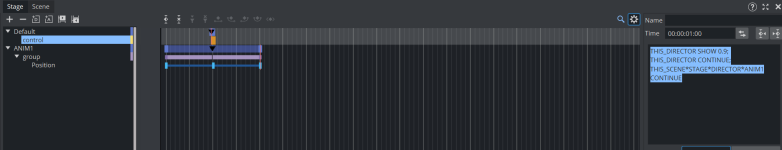

you can try something like this in your action keyframe:
Code:
THIS_DIRECTOR SHOW 0.9;
THIS_DIRECTOR CONTINUE;
THIS_SCENE*STAGE*DIRECTOR*ANIM1 CONTINUE
in this example the default director is locked in a loop that continues the ANIM1 dir every time continue received.

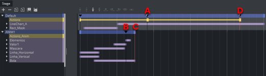

For example:
When the playhead reaches A, it stops at the Stop tag and the Action makes the ANIM1 director start.
The animation of ANIM1 plays until it reaches the Stop tag at B.
Now, I would like to play the rest of the animation until C and then continue the animation from A to D.
The problem is that when the animation stops at B, if I press Continue, the playhead continues from A.
My "chicken-wire" solution was to place an Action right after the Action at frame A, that forces the ANIM1 director to continue.
But I would like it to finish the animation from B to C when I press Continue, and only after that go on from A to D.
I know I can place an Action at C that tells the Default director to continue. But my problem is that as soon as I press Continue at the Stop at B, the playhead goes on from A, not from B.

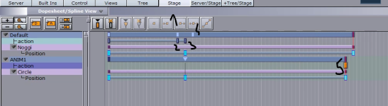

I can recommend that instead of the stop point in your Default director, set the following:
  1. A tag named "stop1"
  2. Under it, an action keyframe to trigger the ANIM1 director:
    Code:
    THIS_SCENE*STAGE*DIRECTOR*$ANIM1 START;
  3. One frame after that action keyframe, add another one with the command:
    Code:
    THIS_DIRECTOR SHOW $stop1;
  4. One frame after that action keyframe, add another tag named "continue1"
  5. And at the end of your ANIM1 director, set an action keyframe to continue the Default director:
    Code:
    THIS_SCENE*STAGE*DIRECTOR*$Default SHOW $continue1;
    THIS_SCENE*STAGE*DIRECTOR*$Default CONTINUE;
It's a bit cumbersome, but it will solve your issue.
